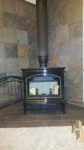

Thanks for the patience as I got a chance to add an update. A few months later, I've warmed up to the stove a bit (pun intended).
I still wish I had gone with a new VC or other cat stove, but this stove is really simple to operate, and our chimney is much cleaner than it has been with the old Encore. The biggest adjustment we had to make is how we load the wood. I'm used to packing the stove up to the gills, letting it catch and then turning the air back. This stove does best for us if we ration the wood out over the day. It's the only way we can get consistent temperatures out of it, and not get roasted out of the room. I'm still not sure if the height of our chimney (18+ ft.) or the diameter of it (8") is playing a role, but I'm not going to spend another $1,000.00+ on new chimney to find out. It did keep us warm through that cold snap of -15 degree weather and windchill of 40 below.
The Explorer blows through wood a lot faster than our old stove. I bring prodigious amounts of wood in, and it seems like a couple of days later, I'm repeating the ordeal. I really thought that efficiency would be comparable to our Encore (which had a cat in need of replacing and some issues with the refractory - it turned out to have a hole in the top of the cat chamber which partially bypassed the cat!) but I think that it is about as efficient at a given temperature, but not as adjustable or as flexible. I'm still really disappointed with the top-load feature, if you wait till you're down to coals, you're ok, but you still get a blast of heat off of them that was not as noticeable with the Encore. The implementation just isn't as polished, and probably can never be with a tube stove.
Thanks for the support and similar sentiments. I think the stove looks nice, it's huge, throws a lot of heat, and is difficult to regulate. The major plus is that after checking periodically, we are getting way less creosote in the chimney (probably partially attributable to how hot it runs!), so it now feels as safe as the last one did.
A couple of pics of the setup:
Installation:

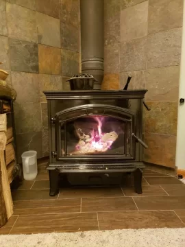

Today:

The Encore was thermostatically controlled, this is a completely different setup. Have you tried thicker splits to slow down the burn a bit? With a full load of wood, when are you deciding to turn down the air and how far?

I do realize that the Encore had the thermostatic control, and I knew that this one wouldn't have it going in. I just wrongly assumed that the air controls on the front of this stove would be able to cut the air down much more than they really do. That's completely my fault for not getting some sort of a demo, but in NW Ohio, I was lucky to see one on the floor, much less hooked up and running.
On the Encore, I'd let it catch and then turn it back most of the way, and that would "cruise" at the given temp for most of the night. On this one, it will run away from me if I use the ACC, regardless of where the primary air control is set. For an overnight burn on the Explorer III, I really only let it go from 5-10 minutes (a guess) after loading before I shut the air all the way down if I want to maintain some semblance of an overnight, even burn. I try to load up the biggest splits I can find for the overnight burn, then fill in the cracks with smaller pieces for more total mass and less initial airspace.
