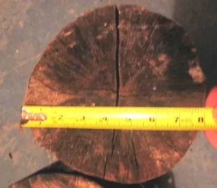

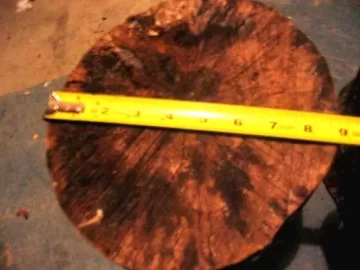

He is a pic of the type of wood I load for extended burns. Are you guys loading 8" and 9" rounds?

Carpniels, are you adding wood like this? These two logs will be loaded north/south at one time and any remaining space at the top will be filled with smaller splits, the smaller splits give an immediate "top down secondary". By the time the smaller splits at the top are burt down the larger logs are well on there way and are able to sustain secondary by themselves.

Yeppers , large hardwood and well seasoned wood is going to make a world of difference in heat and burn times. Rounds will be a key to larger wood.

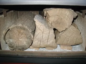

Pictured below is a pic of the Summit load with large splits and a round about 8" across. The pic is just for example of log size and shown as loaded in a non hot coal stove.

Thanks...just goes to show ya the S.O.N.A(Summit Owners of North America) are always lookin to help a brother out. :snake:

I could not believe the size of those rounds. 9 inch and unsplit. Doesn't that take forever to dry? I normally split ever piece of wood at least once, to get the bark broken and improve drying capacity.
Remember, I am still trying to get rid of all the wood I cut for my Castine and VC intrepid II. those are much smaller stoves so a lot of my wood is small (16 inch long and maybe 4 inch across. Naturally, that does not help with burn times.
I will go to my woodpile and see if I have anything close to that size and load it up the way Gunner did. Lets see what that does.
