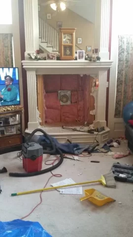

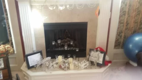

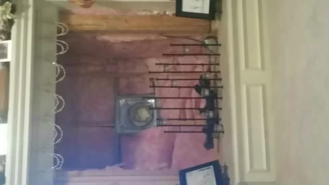

I demolished my light bulb fire simmulator out of the alcove in my living room and I am about to put a zero clearance insert in its place.
I have a quote for a Quadrafire CB 1200 ready to go, but I'm vacillating between it and a Harman P35i. My house is a reverse story and a half about 2100 square feet with a vaulted ceiling extending up to the upper area.

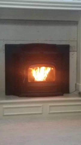

Just pulled the trigger on a Harman Accentra 52i. Install service appointment on the 9th of January. Since it is going to be a Zero Clearnce install I'm having done by the recommended installer from the vendor. Hopefully I'll get it running shortly afterwords.

Nice! Be sure to post some photos, we like photos.

Looks good!

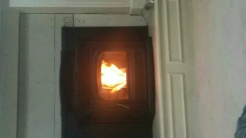

Nice! So what do you think so far, throw out enough heat for you?
Plenty of heat took the lower keel from 65 to 74 in about an hour. Upstair bedrooms warm because of the vaulted ceilings. Master Bed room a bit cool but do able. All in all it kicks the heat out pretty darn good. Still playing with adjustments.
