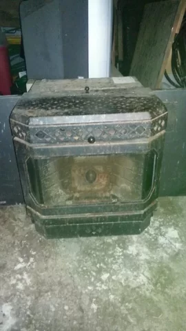

Model number, pictures help
I believe it is a cb1200i. For the record the hubby disconnected it, I told him to just unplug it but he has his own way of doing things(*sigh). After reading the manual online, I think it may have been the thermostat or thermostat connections. I hope he didn't fry the control panel. If limit switches are tripped, how do we fix that? Any thoughts on the thermostat? It seems to make since since the unit didn't shut off...It was like it didn't know how warm it was. If it is the thermostat can we get a replacement? If it is the control board, can we get a replacement? It is an older unit but maybe they are all compatible. Thanks for any info.
Picture of stove was before cleaning and repainting but I hope it will help in the de [Hearth.com] Quadrafire pellet insert is possessed, please help. tective work. ( :
