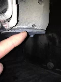

In any event, I'm glad you got the problem solved. Now check to make sure that the trap door is not hanging down with a gap of more than the thickness of a dime. Any more and you short circuit those 8 little holes too much.

Thanks tj I'll have to check that gap tomorrow when it's cool. but a question, the bolt was loosened slightly, I can't detect any change in the flame pattern. Is there a danger with damage to the stove by doing so?

Just curious where the reference that the gap should be no more than the thickness of a dime? I keep mine much tighter, so that its almost dragging when clean.
The thickness of a dime has been quoted here for several years. While the origin is unknown to me, I believe it came from a tech or factory rep. Yes, the tighter the better but the caution is to not have MORE than that. Also over time the nut may loosen and cause the plate to droop, which can be a cause for poor burning, non-ejection of the ash from the burn pot by the vortex of air, and poor heat output so it is always something to have the guy with the problem check.

The dime reference is to the "sag", or lack of, here. I've replaced my hardware with stainless and an all metal locknut, and hand filed my plate and spacer to fit very true. I had the nut loosen a little this winter and it burned noticeably inefficient. It can get a little jammed up at times, but I like the burn with the better fit. If I just loosen the lock a tick, it opens very smoothly. I also like it snug to keep my young'en from being tempted to pull on it while burning. It hasn't happened but I like to rule things out.

The factory seems to tighten the "hinge bolt" very tight from factory I would remove the plate and sand or scrape flat like new again, re-install and tighten it with a dime pinched in the opposite side of the plate across from the hinge you don't want it too loose, but you also don't want it so tight that it aggravates you every day
