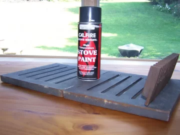

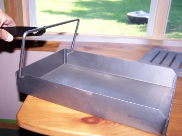

My Esse cookstove came with very thick coal grates .. Never have tried coal in her.. Also a really nice deep ashpan as well.. Right now I run the deep wood box for firewood..
