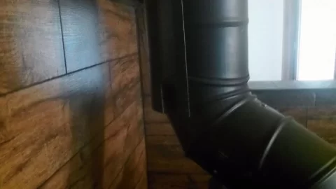

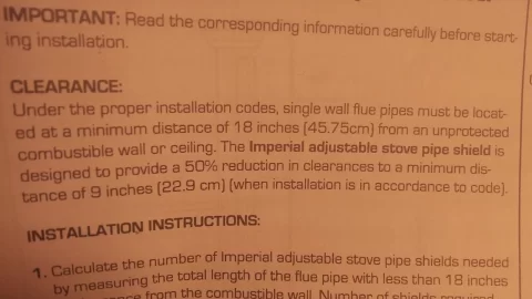

the nfpa 66% reduction on wall behind the connector will allow you down to 6 inches. the ul listed stove pipe shields which mount to the pipe allow only 50% reduction down to 9 inches. im 11 inches from combustables and have both for piece of mind lol.
I don't believe these will have any signifigant change in horizontal output as each of the protrusions is essentially an airgap with a radiant barrier. heat would get trapped in that space and forced to move vertically. which would in theory actually decrease clearance (although not very much) as well as the flat spots that actually contact the pipe don't add any substantial amount of surface area to the pipe.

Hmm, looks like some say it reduces clearance 50% and others say to 6", but I think you are correct at least for ceiling clearance.
"Using a "Heat Shield" on a single wall stovepipe allows you to reduce the clearances from 18" to 6" to the wall and 9" to the ceiling."

my bad I was going by the brand I have which is an adjustable length. if I remember correctly I bought this brand because the ad specified it was ul listed. and some of the others I looked at made no mention as to a ul listing. which seemed to me like if they had the listing they would have advertised it. but I cannot say 100% they were not cause I didn't buy the other brands I looked at to read their literature to verify if they were or not.
[Hearth.com] Question about 2 things i've seen on youtube
if you read the last question (number 6 click to see them all) in the homesaver brand it says no documentation could be found and that it meets nfpa 9.5.1.2. on page 32, as in it is a 24 guage heat shield with 1 inch airgap. however if you go up to 9.5.1.1 diagram it shows how wide your protection must be. but doesn't describe at all what the reduction would be if placed partially around the pipe and not flat on wall. or how far around the pipe it must go ect. so I don't know if that is their interpretation of the code or what. but ul listed has actually been tested.
