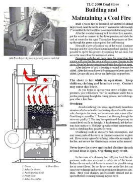

I am working on getting new glass. I have another question. When burning coal, how do you light it. Do you start a wood fire and then add the coal. Also, how do you know how much coal to put on, seems if you put to much on it will snuff everything out.
You need a good bed of coals from a hot wood fire. Coal needs a lot of heat to get going. The better the coal, the less volatiles in it and the higher the carbon content, thus the more heat it needs to combust. Then you need to layer on the coal. Thin layer and wait for it to take, then add the next layer, wait for that to take, then the next. Once it is burning hot, you can shut down the primary air some for a long long burn. See this link (broken link removed to http://www.harmanstoves.com/doc/tlc2000m.pdf) for instructions for the Harman coal stove. Page 9 of thr PDF gives pretty clear instruction. I will attach a copy of that page for easy access too.
