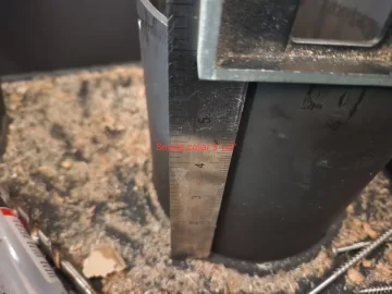

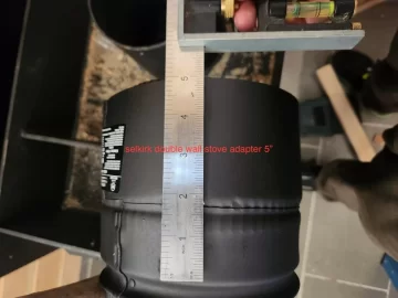

I have a lamppa kuuma sauna stove. The smoke collar is 5-1/2" long. I am trying to install selkirk double wall pipe on to it, so I bought the selkirk DSP6SA-1 stove adapter. The length of this that would slip over the smoke collar is only 5" long, and in any case I can only slip it 1-1/2" down on the smoke collar. But even if I could slip it down all the way it wouldn't bottom out on the stove. So I think what I have to do is put this as far down as I can on the smoke collar (1-1/2") and then use the holes in it as pilots to drill NEW holes in the smoke collar. It seems kinda crazy to drill new holes in the smoke collar of a wood stove.

The main concern with the single-wall vs double-wall in this short run of pipe is clearance. Single-wall needs 18" vs double-wall at 6". The stove flue collar is long and unshielded. Is that because rocks are going to be placed around it up to 4-5"? Otherwise, even with the DSP on top, there will be 6" of unshielded pipe.
1.5" is ok for seating the adapter. Do you need a DSP adapter or will the stovepipe sit snugly in the flue collar without it?
