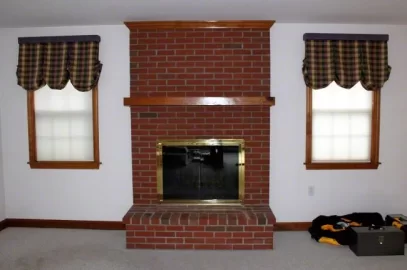

We are currently in the midst of a first floor renovation. We have in our family room a floor to ceiling brick veneer wood fireplace similar to the one in this picture (to give you an idea of what it looks like):
[Hearth.com] Question about renovating a wood fireplace hearth
We have discussed various ideas as my wife hates the thing. One thought was attach a piece of granite that she liked to the top of the brick on the hearth and then trim out the sides. However, the hearth extension sits flat to the opening of the firebox. Therefore, if you laid a 3/4 to 1 inch granite piece on top of the brick, the hearth extension is now that much higher than the firebox opening and I don't believe we'd be able to then put back the glass doors we currently have there and would like to reuse. I don't know it's even allowed to now have the hearth extension almost an inch higher than the firebox opening.

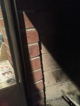

There is no crack but it's hard to tell. There is a wall of regular brick that appears to be decorative like in the picture in the first post. The hearth extension is also brick attached to the wall of brick. When I look inside the firebox, I can see that the brick veneer (for lack of a better term) is up against the face of the fireplace.

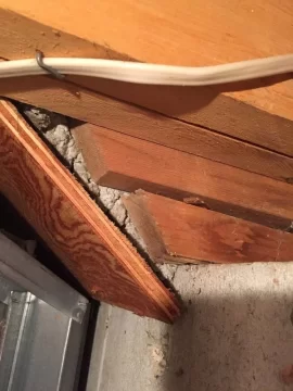

Also, it does appear there is a concrete pad. Our basement is finished but there is a drop ceiling and I looked and there are some plywood panels nailed at a 45 degree angle between the joists right under where the hearth extension would be and there appears to be concrete behind those panels, if that makes sense.

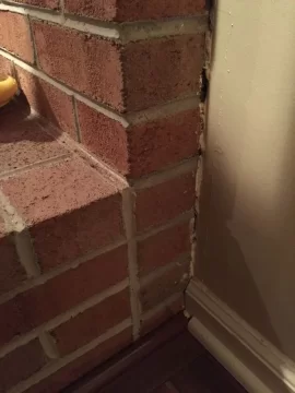

Just a few photos.......... first is the connection between the wall and hearth extension, second is what I think is the pad, third is the inside of the firebox where there interior brick decorative wall meets the firebox.

You have a 45 degree "slab" poured in the basement ceiling to support that hearth. That is commonly done, that makes the hearth setting on a solid concrete foundation. You are good to go, very good support for that hearth.
Glad to know they did it right when they built the house!
So it looks like have options now............. I can tile or use granite on top of the existing brick extension or just rip the extension out as well right along that vertical mortar line between the extension and the wall of brick (the one plan is to remove the upper half of that brick wall and drywall it or panel it and then leave the bottom half).
