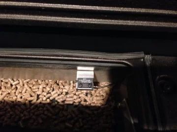

There are two magnetic switches on this stove. For the hopper, it is on the right upper corner, when looking at the hopper from the top. You will see two small black rectangles. Within a second of lifting the hopper lid, my wall control notes the lid is open. The switch is an override for the feed motor (there is also one on the glass door). The fire will burn it self out in a few minutes. Is your stove the Mt. Vernon AE, or the Mt. Vernon E2? I'm talking about the Mt. Vernon AE.
When I looked under the hopper lid with the flashlight and mirror, I saw a silver metal rectangle with some type of wire attached and there was one black rectangle on it. Maybe it's missing a black rectangle? We have the MVAE.

Sorry it's a single rectangle. Here is mine.

Mine looks a little different - maybe it was installed incorrectly. Have to see if I can get a better look at it.

The switch on the lid on mine doesn't always work right. Most of the time when I open my lid the icon will show up on the thermostat and stop feeding. I have to tap my lid then the light icon goes off. Maybe you need to take your top lid off and reposition it?
Mystery solved! Two part solution actually. We removed the lid and then checked the wire connections in the back of the stove and it turns out that they put a bypass wire in so when we removed that, the icon lit up (yay!). However, when we replaced the lid, the icon did not go off. Hopper lid off again and, thanks to John193's photo, we realized the black rectangle thing was on upside down and wasn't making contact with the magnet. We reversed it and there ya go - icon on when hopper open, icon off when closed. We checked the door and the icon appears properly when opened and disappears when closed.
