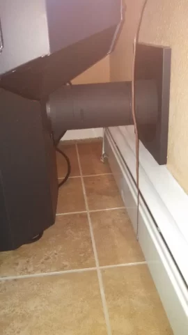

Back to the OPs question. I have a similar situation. My newly installed P43 is leaking between the stove adapter and a 6 inch, and the 6 inch and a 1 foot section inside the house. It is the Silicon duravent that supposedly doesn't need additional sealing. I used rvt on the adapter and it seals great.
I never would have noticed the faint trickle of smoke if I didn't read this forum. I got behind the stove with a flashlight in start up and noticed a small amount coming from those two joints.
Recommendations? The pipe claims to not need to be sealed. And I don't want to use tape as I have painted the pipe.
  • [Hearth.com] Question about stove adapter
Even with the new duravent I think they say you "may" have to put sealer on the edge when installing pipe,their instructions on website show this.Also is a good idea to replace the gaskets whenever it has been taken apart.Also make sure screws are not too long,serviced 2 stoves that had too long screws through pipe and it pushes the inner liner inwards and allows smoke to bleed into outer liner.
I took it apart and siliconed the joints. There was still a small amount coming from the last joint, so I painted some tape and sealed with that. No more leaks!
