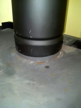

I am having a similar problem and would like to know what people think. The telescoping dbl wall stove pipe has three holes that do not line up with the holes in the stove collar. The outer layer of the double wall stove pipe fits pretty snuggly around the outside of the stove collar and will slide down until the indent if I don't secure it with screws to the collar. Any ideas or thoughts?
Here is a photo of the double wall stove pipe on the stove collar without any screws. The collar is up in the stove pipe up to the indent.

You can either drill new holes in the pipe or do nothing. If the collar is up all the way to the detent, I can't see a problem leaving it like that, no screws. However, if no screws bothers you, just drill new holes there in the pipe. Easy to do, I did it on a short run of adjustable [Selkirk] I had to install for one of my stoves [see my avatar to the left there]. You just have to remove the screws to disassemble the pipe to clean it.

The outer layer of the double wall stove pipe fits very tight. I would not be able to get screws in the existing holes. I suppose I could line up one of the holes and throw a screw in it. I think that would be better than what she suggested.
