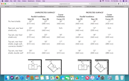

Here is the owner's manual that says, no heat shield, 18" in rear with a protected surface and a clearance of 12" with the heat shield and a protected surface. To be on the safe side, we will get and install the heat shields~ thanks for the heads up about them.

Good deal. The only place you would not have the bottom heat shield is in something like a fireplace or on a cement slab.
