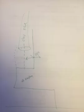

we have a guy installing a Pacific Energy Neo 1.6 in our cabin on Monday. Originally, we were going to go with the neo 2.5 but because of a height restriction we had to change our plans to the 1.6. The question I have involves the distance from the face of the stove back to the center of the flue. Our fireplace has about 14” but the neo 1.6 is only 10”. I’m not sure what the installer is planning on doing but I’m concerned about what he may try. Is there a good way to fix that? Elbow of some kind? The cabin is in a rural area and this guy has given me a bit of a bad vibe with some of things he says. I just don’t want to cut any corners when I’m paying to have it installed “correctly”

Thank you for your reply. I’m in exactly the situation you describe. I don’t know for sure if I really have a problem yet, or if I’m just worrying. I’m hoping to get some educated opinions from the pros on here. Maybe the flexibility of the flex liner will accommodate a bit of bending to offset the 4”?
I was wondering if an elbow was an acceptable solution. Thank you
As long as it is a stainless one meant to be used with that liner yes it is fine

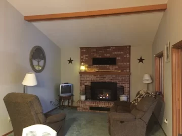

Ok. Separate question, the insert is going into an old heatilator fire box. Is that a situation where you would need a block off plate? It’s essentially a large steel firebox built into a masonry chimney. I attached a picture with the current gas insert
  • [Hearth.com] Question about wood insert install
Yes
