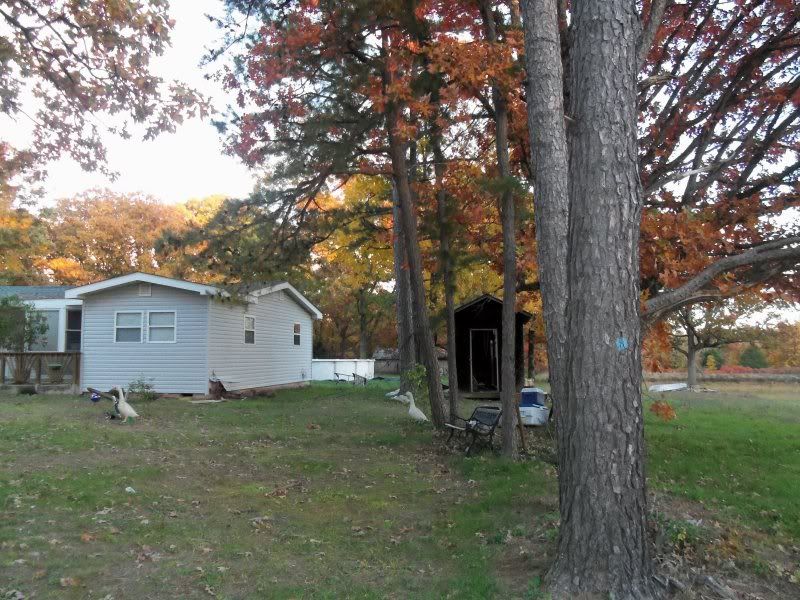

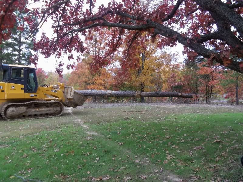

we pushed over this row of pines when I started my addition and sold what I could for logs. They wouldnt take anything less than 10" so I have a stack of about 6 small logs that were pushed over in October.How long would it take for this to dry? And do you guys have any suggestions on what brand or model of moisture meter to get?

Fire wood don't start to season much until it's split & stacked off the ground in the sun &/or breezy area.
When did you split & stack the pine?
Figure a year for green pine. 2 years & it's real good wood ;)
