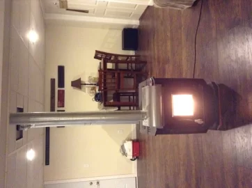

Does this count? Not as fancy as yours. Heats 2000sq.' Ranch and the basement it is in.
[Hearth.com] Question for those using ducting to heat upper level
  • [Hearth.com] Question for those using ducting to heat upper level
