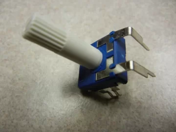

What are "pots" what piece is this?
Critical switch. Controls the fan and one to for the feed . Limited cycle life :(
The proper name is potentiometer or pot for short. It is a variable resistor located on the control board. It consists of wire wrapped around a core that can be adjusted by moving a wiper connected to a knob. With age the wiper develops dead spots and no longer makes good contact with the wire. Replacement is the only recourse.

Just finished the three 100k pot replacement on the Advance and as typical one knob shaft finger broke off so now I'll have to order a knob/shaft. Also replaced the 1000uf/16vdc cap with a 25vdc. Its was just good practice! Its now the feed pot knob which is typically set and forget. So its not a big issue and I can adjust with screw driver.
