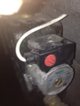

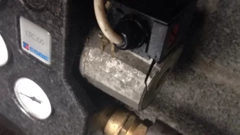

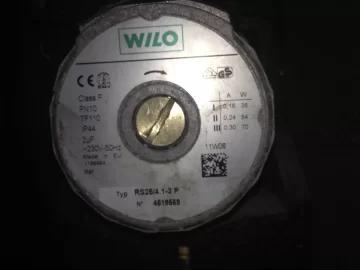

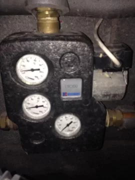

However I noticed also I have an ESBE LTC100 valve system the pump has cracked which was a Wilo RS25/4 - does anyone know what pump I can use to replace it as RS25/4 seems to be discontinued - Thanks Manjit
