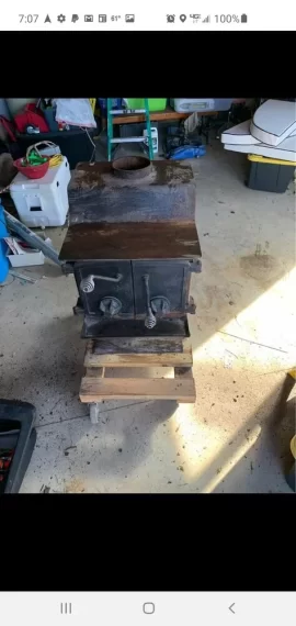

I just bought this honey bear for a great deal. It has solid doors and is in great condition with a little tlc in the near future. I am curious as to how rare this particular honey bear model is as I can't find any info on this solid door vs the glass doors. The only thing I see wrong is the missing backing plate and information tag. I am also looking for specs on firebrick and fire rope for this honey bear as well. It does has the steel baffle plate in the outlet pipe. Any info you have is greatly appreciated as I would love to know more history on this particular model. Thanks!

Welcome to the Forum Draft!
No sales numbers are available for different models, but since the Honey Bear was designed with glass doors first, the only way you find a solid door is if someone bought the optional solid doors before they went to the integral intakes below and above doors, and before the pull slider for the Convertible model.
As far as door gasket, does it have the regular 1 inch channel iron on stove front and raised section on door to make contact in center of seal channel iron? I've never seen a solid door made to use door gasket material. You can test the seal when closing doors. Latch and pull in and out. They should be tight with no play which is the clearance for door gasket material. The edges of door seal normally contact the back of door on both sides of the raised portion. A dab of grease in the door seal channel and on the edges of sealing iron will show contact on doors when closed. When closed, the space between door and stove front should be the thickness of the web of the door sealing channel iron. Stoves with no channel iron were made for glass which used rope on door.
The brick should be fit across the back first. Then fill in the sides rear to front. The front brick may need to be cut. Very easy scoring with a masonry blade in a circular saw and snap. They cut easy. Then fill in the bottom to hold sides tight. Normally lengthwise across the stove left to right. Cut the right side piece to fit. Then start the next course towards front with the cut piece to stagger joints. Cut front row as needed. Just keep it as clean as possible inside since any debris makes it impossible to fit them snug. They will fill in with ash if this is a user. My collector stoves I leave empty for air circulation.
It's a shame the rear shield is missing. Early ones like this may have had the tag on shield. Later models have a sticker on pedestal that often gets painted over.
I can mike the shield thickness to figure out the gauge steel used. I know they were cold rolled steel for a smooth consistent finish. I'll measure the radius bend at top and overall height with bend if you want to make one. I need to figure out the specs on the shield anyway.

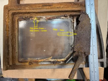

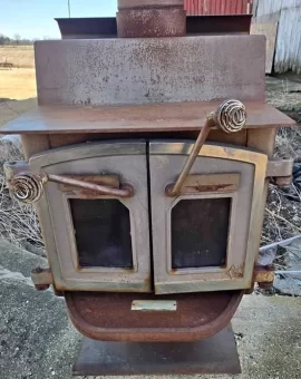

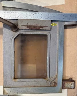

Hi!
Im a longtime lurker but now new member at Hearth.com. I have never owned an interesting stove - mostly old Franklins & box stoves - which served me well enough. But something recently changed!
I obtained a genuine Fisher Honey Bear (pretty sure that's what it is) as a barn find. Yes. It was in a barn in rural Wisconsin. It was very cheap due to needing some restoration, so I drove 70 miles for it.
The main stove body is excellent. Battleship plate, these things. My restoration consists of cleaning it all out, including replacing all the firebricks. I want to start with clean metal and a new firebox. Also, fixing the doors. Mine appears to be the first type. It has air intake through the door with a slider and holes above glass for constant air wash. No other air intake that I can see.
Regarding the doors, two of the hinges are broken off and stuck in the door hinges. No worries. Some heat + PB Blaster will let me press those out. There are a couple plates on the inside of the door that screw in right behind the air inlets. Are those there to direct the air downwards across the glass? I only have one which is almost rusted off. The other side is missing. Do those air vents slide in and out to regulate the flow? Mine are both rusted stuck (for now), so I need to know if they are supposed to move in and out before I start to clean and wiggle them. If they don't move, is a damper the only method of air control?
I will also have a treat heating up and removing all the screws that hold the glass retainers.
Are there any vendors (or members) that stock or fabricate parts for old Fishers? I can probably fabricate functional pieces, but actual replacement parts are better.
The full size stove pic is exactly as I found it, next to the barn.
Thanks for any assistance!

Early Honey Bears had door slider only. The air wash plates inside don’t move.
The first stoves with air dampers on the stove body has holes drilled across the stove above and below door opening. A sliding plate across top and bottom had a tang sticking out the right side using a miniature poker type tool to slide open and closed. Later models had a pull rod front and center below ash fender allowing air in across bottom of doors.
Worst case scenario is drilling out the old hinge pins. They were solid rivets. Not bad when a portion sticks out you can rotate first with your choice of penetrating oil soaked a few days. Support the door hinge or hinge plate using a drift punch.
You can make new pins easily with a bolt. Choose one with unthreaded shank below head long enough. Grind hex head points round. Chuck bolt in a drill, and form rounded head rotating bolt against a running bench grinder wheel. (Running drill in reverse direction of bench grinder wheel) If no bench grinder, a flat machine file works like machine filing in a lathe. Use silver anti-seize on hinge pins yearly. Better and higher temperature than most high temp grease.
Glass retainers are flat steel. Normally flat gasket material was wrapped around glass edge so gasket contacts door and retainer letting glass float in between. Parts are fabricated.
Does this stove have any baffle plate below outlet? Two different types were used. Depending on chimney and baffle, flue damper may be required.
