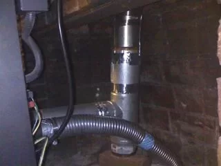

In the picture attached, the flex pipe is Attached to The exhaust. What is the tee attached to and wouldnt you want the tee to be attached to the exhaust so you can collect the ash and debris. Im buying a Breckwell sonora insert and to my knowledge only has an exhaust. Where does the debris go?
Why didnt this person use their tee as their outside exhaust instead of the dryer vent?
Im thinking of either busting through the bottom of my existing fireplace down into the basement and then out or through the back of the chimney.
Has anyone done this? and if so, how did you install it?

Are you talking about the exhaust from the stove, or the fresh air vent? The combustion exhaust pipe CANNOT go down and out, if that's what your thinking of doing. In the picture, it's done correctly....exhaust goes up (fresh air flex pipe can go any direction).
I think some folks are confused about what they are looking at.
Stevie, the flex pipe you see coming off the stove is not the exhaust,
it is the intake.

The flex pipe shown here is going down through the ash dump, then
out the basement wall. This pipe is the fresh air INTAKE. It is not an
exhaust. Here is the view from the outside.

The T shown in the pic above and a couple of additional pics: the stove exhaust to T, up chimney with ss flex.

So then I was wondering why cant you exhaust down and out? I would only exhaust down 3 feet down and then horizontally out through the wall?

Mine is about 20 ft so the easiest way was the T, into ss flex all the way
up the chimney and capped.
