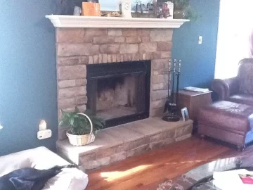

    I replaced my Majestic ZC and triple wall chimney with an Alderla T4 (for close clearances) and class A chimney. I couldn't find an approved insert for mine, but I was more interested in going with a stove. I wouldn't recommend piping a class A through the triple. I looked into that too, but it seemed like I was adding complexity if there were any problems with the system in the future.
    It was and expensive upgrade, but in my opinion, it was the right thing to do.
  15. Jjm457
    Jjm457
    Member 2.
    Jan 10, 2012
    28
    17
    SW Virginia
    My house built in 1988 came with crappy Majestic RC36 ZC with triple wall
    through chase. I didn't get much support from Majestic when I inquired about an
    insert. With that said, the end of last year, I had a local dealer order and
    install a Regency i1200 wood insert, along with a 6" stainless steel liner. It
    went in with an offset and does the trick for me, it's very small, but it fit.
    I am not a full time or overnight burner, but this does put out some heat,
    especially when blower on.
