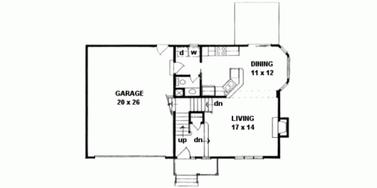

Hello Everyone, this my first time on this forum, and the reason is Im puzzled on which zero clearance stove to install in my new contruction home and how to set it up. Im not totally green to wood burning, but Ive never had a stove of my own, it was always my parents or relitives. So what I got is a 1800 sq ft, 2 story home, in the planing stages anyway, its in Alaska so it gets pretty cold in the winters 20 above to 20 below normally. Its a 5 star rated home with natural gas heat. The fireplace dealers here kind of limit my selection but Ive looked a lot at the RSF onyx or opel, fireplace extrodinar, and the supreme plus. The supreme I have not herd much about, but it looks like a good quality stove. Anyone know much about the Supreme stoves? But my biggest consern is how to build the chase. The plans call for an outside wall chase....built out...so the stove is flush to the wall. Everything Ive reserched has told me not to build the chimney outside because temp difference in the chimney and house causes backdraft when not in use and during start up. Any thoughts or ideas would help. Ill see if I can get picture of the layout on the main floor on here. Gillen

Welcome to the forum. I'd go with the Fireplace extraordinaire it's a very good well built fireplace. You might want to also consider a centrally located wood stove on a nice hearth, it would be cheaper and heat the whole house better without the use of fans and blowers. An inside chimney has many advantages over an outside but you also need the space for it.
I think the key is to insulate the box (chase) that you build outside - up to a certain height (ceiling height of the first floor or so), and then you should should not have any problem. Also, use a unit which accepts solid insulated chimney as opposed to air-insulated.
All of those units are decent, but you should lean toward two things IMHO. First, look for those which heat well without a blower (even if a blower is options). Also, lean toward the larger fireboxes...doesn't have to be the biggest, but not the smallest either....because you are probably going to burn softer woods in Alaska.
Although the FPX is a nice unit (I sold them for years), I might not choose it for a super cold climate and also it has more parts, blowers, etc. than some of the other. I might be behind the times, but earlier ones were catalytic and used air-cooled pipe.

I have to agree on the freestanding, if room allows. Looks like the laundry room and adjacent bathroom could be a little cool, maybe plan on some ducting (within code) to get some heat back there. Other than that, looks like a good open layout. MUCH easier to do all these changes while still in planning and building stages.
Welcome Gillen, It is good you are thinking this through and also seeking advice. Either keep the chimney inside, or insulate it to the hilt if it is exterior, especially in your climate. Makes sense to keep it inside. However, since it will now "bump in" to your living area you might as well consider a free standing stove. Modern stoves have a nice large viewing window that will more than equal the pleasure of a typical fireplace. You can always simulate the look of a fireplace wall behind your stove. The stove will be less expensive, an easier install, and heat easier.
Thanks for the reply guys. Ive heard a lot of good things about all three of these units, price is an issue as well, theres 4000 in the budget for stove and pipe but Im pretty sure Im going over that, (way over). Ive been looking into the central heating option, or at least the heat dump, do any of you have any input in this department, theres a bonus room over the garage that will be challenging to heat with out it. Ive read a lot on the system but real world experience is always the best for me. PS. Any Input on the Supreme plus? Thank you Gillen

Yes I thought about moving the stove and also a free standing, but because of layout and room we kept comming back to the original plan

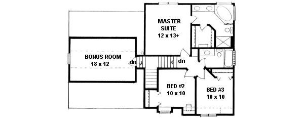

With that floor plan, I would consider a central location next to the entry closet and stairs. It would mean giving up a bit of space in BED #2 to a chase but if you vented the chase on the foyer side it would heat the upstairs nicely. My former home had an RSF but with a central chimney. My current home has the same model RSF bumped into the room and the chimney chased up the interior of an exterior wall of the master WIC.
I'd sure try to alter these plans to put a 3 CF freestanding stove in a central location with class A chimney in a ventilated chase from 2nd floor to cap. If you truly want to rely on wood heat when -20F...a ZC fireplace hanging outside the house isn't best option. Maybe place stove to right of "dn" in top pic? And price wise - Englander 30NC, 6 ' singlewall pipe, 14' Class A, ceiling support kit, chase, hearth would be $2200 or so, if you did work yourself.
You know, over by the entry would work, mainly because the stairs to the basement will not be there, an option that was not in the bugdet. Also the coin saved would be a bonus!! I think I would enjoy a freestanding stove over the Z.C. type anyway, seems to me they give off more heat and it would definitly heat the upstairs better. So a 3 CF. stove would be good? would you go any smaller? How would the vent for the chimney work? Is it a hole cut in the sheetrock with a vent? Or is there more involved? Gillen
If at all possible, you'll want to run the flue straight up. That means some careful planning in that area. Not sure how the plans have been updated, but there will need to be a chase through the upstairs bedroom. This can be boxed in and if possible placed in a bedroom closet.
This is a good Idea. Space wise that area wasnt going to be used much anyway, and with the stairs to the basement gone I can run the chimney strait up the wall of bedroom #2 on the hallway side of the room, not an ideal location but possible. How big would the chase box need to be?
The pipe needs 2" clearance from combustibles and is 8" OD for 6" pipe, so the ID of the chase needs to be 12", add framing and cladding to come up with the final OD. With 2x3s and 1/2" rock it would stick out about 15" into the room.
If you let it into the wall, it won't protrude so far into the room. Install a cold air return grille at the baseboard and a low profile grille at the top of the chase. You would be surprised how much air moves through the chase. Consider framing the chase with 2x2 metal studs. They will stay straight as an arrow and don't burn either.
