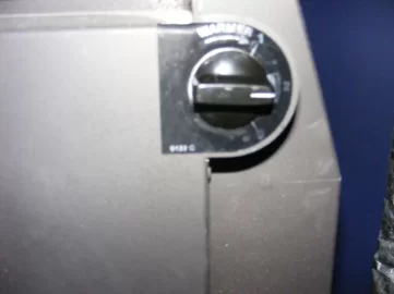

Hey Rusty look at the attached pic. The set screw at this position in the pic that holds the knob on is facing toward the front of the stove. That would be the flat spot side of the shaft.
This should help. Sorry about the pic quality.
N of 60

Looks like the piece with the 1/2/3 numbers is attached to the side shield.
I asked for the side shields to be removed before mine was painted. Meanwhile,
there IS no "flat spot" on the shaft on mine. Hmm ...
