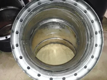

On the elbows you removed I would recommend to just clean them with a wire brush. I wouldn't use sandpaper as that is likely to sand away any protective finish the pipe might have on its surface. Also, such minute cleaning isn't necessary, at any rate. I just use a stiff wire hand brush and knock the pipe a bit with the wooden handle and that seems to provide adequate cleaning in my experience.
Little too late on the sand paper. I thought about protective finish but proceeded anyway. This doesn't hurt the integrity of the pipe right? Maybe my drill doesn't spin fast enough. Its an older one

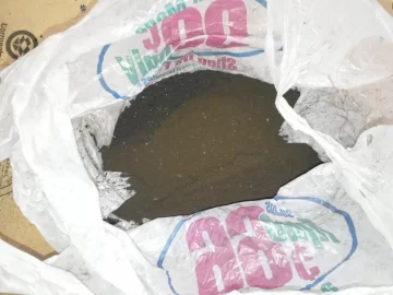

Here's a pic of the cleaned elbow. I'm a bit obsessive about cleaning things. And a pic of the creosote. About 2 cups worth from ~18' of pipe. I could also pick up a metal chimney brush at lowes and run that up through the pipe.

The thing about sandpaper is it scores the surface and all those microscopic grooves left behind are places for soot and creosote to get a grip on the surface of the pipe. The smoother the pipe is the less susceptible it is to getting a build up of anything on it. I'm sure you didn't do any major harm, but from a technical standpoint I don't think it's good practice or necessary.
