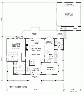

I am about to begin construction on a new 2,559 sq.ft. home near Charlotte, NC.

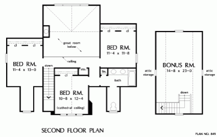

The house is 1.5 stories with large great room, kitchen, master bed etc... downstairs (1,783 sq.ft. downstairs) and 3 more bedrooms upstairs (776 sq.ft. upstairs).
We're doing something else with the detached garage/great room.
There is a balcony on the second floor that opens into (looks down into) the great room (which has high vaulted ceilings).
I plan to move the stove location to the left of where the fireplace is shown in the attached plan.
