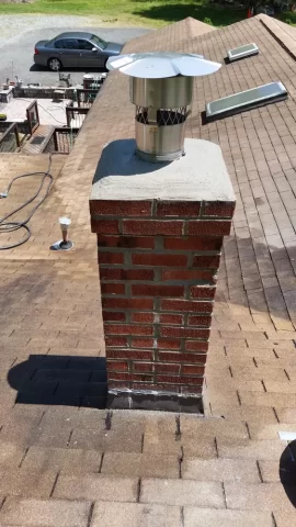

The caps that come with most liner kits will either be a two piece (top plate and a cap) or a topplate with a hingstyle screen cap attatched. Both will normally have screens
[Hearth.com] Quoting wood inserts - what questions to ask? [Hearth.com] Quoting wood inserts - what questions to ask?
The above are an example of a hinge top terricotta mount cap and a top plate with a round cap the top plate can also be secured to a clay flue tile and doesnt have to be made into the crown splash
