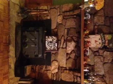

Yes the insert is going into a full masonry fireplace. The hearth extends out from the firebox 17" I am not at home right now but our fireplace is very much like this one minus the stove in it. It is all natural stone laid on top of brick the hearth is not flush with the floor it is about 2' above the subfloor height

It could be ok, especially if the hearth front is supported by the concrete footer. Is there a basement underneath where that can be checked? Some times they pour a cement hearth support that slopes toward the hearth footer. A picture will help us discuss it without so much guesswork.
Is there a basement where you can see what is under the hearth?
