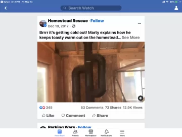

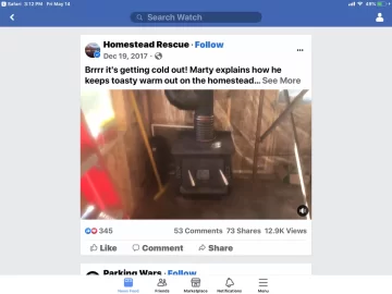

Anyone watch Homestead Rescue Raneys ranch on Discovery channel? I was watching it last night and the fathers house had a bit of a chimney fire that got out of hand and they completely lost their cabin on the homestead they have been working on for most of the show for the last few years. Not too many details as it was the season finale I believe. Anyhow here is/was their setup. It was designed to maximize the amount of heat being transferred to their home. :eek:

That's a shame... I haven't seen the show, but that setup is designed to make as much creosote as heat. They are pulling heat out of the exhaust gasses with a coil, and then intentionally reducing velocity of the gasses with the Tees.
If that is single wall pipe, it looks too close to the combustibles behind it... Supposed to be 18", but perspective of images makes it difficult to tell clearances. I have seen that in some of the pictures I have taken of my setup.

That setup was posted in another thread in the Inglenook. Looks like a creosote trap.
That set up looks like what some anthracite burners make to keep as much heat as possible inside of the house , also many anthracite stoves are called * base burner* cause having long flue path under the firepot to keep the gases heat as long as possible inside of the house.

The stove looks like an antique blaze king, so already low flue temps coupled with a home made magic heat box seems like a recipe for disaster. Most if not all Alaska shows I watch on TV drop standing dead trees and then burn them the same season.
