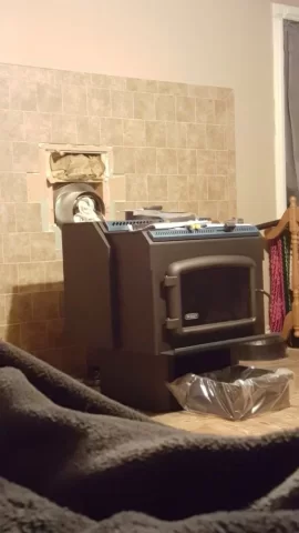

I just bought this house a few months back and the previous owner took the wood stove with him. I decided i want to heat the house with just wood from here on out so i bought a ht2000 which brings me to a "little" issue my thimble is lower than my stove and need to raise it. The chimney was put in after the house was built and is just a pipe in a plywood box. Im guessing a triple insulated pipe with a T at the bottom. I would like to raise the thimble 1', maybe 1.5'. How can i go about this withlut spending thousands?
It looks like you may need to raise it more than a 1.5 feet. Maybe someone knows the exact specs but 2.5-3 feet is usually needed from the stove to the wall thimble/chimney. Your wall thimble and stove look to be nearly equal in height. What type of stove did the previous owner have?

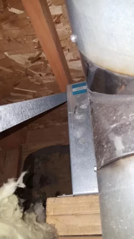

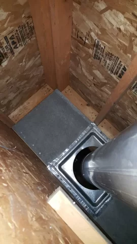

Looks like you are already in the chase in order to take pictures. How long are the chimney lengths in the chase? Can you just remove a length and accept that as the height of the thimble? That would be the least expensive route.

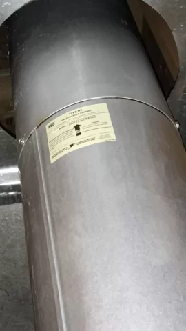

Im not too sure to be honest. Ive been too vusy the last few night to mess with it. I got the pictures from the small hole above the t connection. If i had to guess the bottom pipe goe to almost the ceiling. Maybe just a little lower. If i raised it that tall then would i have to add something to the ceiling to help block the heat?
bholler's right, you'll need to get into the chase to make changes. Then you should be able to raise the chimney up 2-3 ft., then rebrace, and lower the storm collar back down to the top of the flashing.
