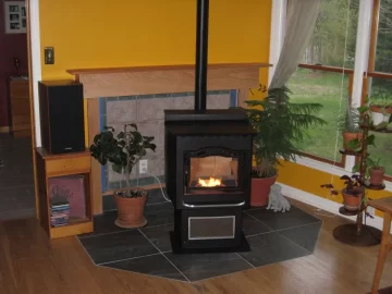

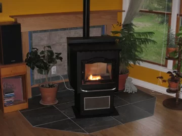

I have my stove within about 3 feet of two widows......They're decent thermal, double pane Andersens and I've never had a problem with the location. Here's a couple photos that will give you an idea of what I'm describing. Note the stove is slightly turned sideways away from the hearth behind it. I did this to help get the heat out into other areas of my house. It looks a bit strange but function over appearance I always say. My dealer also mentioned it was not a problem with windows behind the stove as I have plenty of clearance.

There are accepted standards for proximity to windows and doors. Most stove manufacturers list them in the owners manual. They really come into play if you need a permit/inspection to install a pellet stove in your jurisdiction. You may or may not. Also check with your insurance company. Almost all require notification for new install and changes.....They may require an inspection, and may have their own regs

Ha, ha.....My abnormal install (see a couple posts up) is for the same reason. It blows my warm air out into my kitchen and dining room area much more efficiently. At first the wife didn't like it but once she felt the heat in her kitchen, she came around to my way of thinking.
Basically it just isn't perfectly aligned with the square mantle behind it as the previous stove was. My old Lopi, installed by the previous owner, also sat on top of a raised platform type thing covered in cheap vinyl floor tiles...It actually pointed directly to a sliding door that goes out to one of my decks..While an efficient sliding door, it just seemed that most of the warm air would sort of linger in that area of my living room and only moved slightly due to a ceiling fan above it.
Anyway, the new Harman P61A, porcelain tile floor, hard wood mantle behind it, actual stove layout, etc. is a vast improvement compared to what was originally in this location. I still have the Lopi and may someday install it in my basement or outer storage building.
