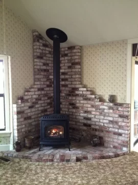

    • My hearth is made from 4" x 2 1/2" brick with a 1" airspace between it and the sheet rock wall and the floor of the hearth sits directly on the plywood sub-floor that has been reinforced with extra floor joists. I'm a little concerned, after reading some of these posts, that my hearth may not be good enough for the clearances that are needed with the new EPA stoves.

    Ok, finally figured out how to post a picture of my hearth.
    Mulebelle

    Welcome Mulebelle it might be a good idea to start a new thread for this. Not trying to be a jerk it will get a lot more traffic on its own. You have a gorgeous hearth too it looks fantastic ;ex

    Thanks Pete. That's a good idea. Tomorrow I'll figure out how to do that and see what becomes of it.
    Thank you for the compliment on the hearth. I just hope it will be large enough for the new EPA stoves.
