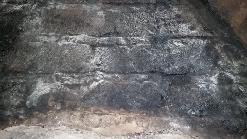

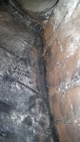

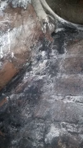

Hi all, been lurking, reading, and finally need to ask you to rate my creosote. The white powder is the Anti Creo Soot powder. I scraped all I could, what a hard job! We cleaned our pipe and it is great but this smoke shelf area is of concern to me. We need to chip away this area and get a liner in. I think we also need to parge this brick with all the holes and gaps. Let me know what y'all think. Husband wants the stove back in and fire her up again. I am skeptical of the safety.

Yeah you will need an 8" liner for that opening. That creosote doesn't look bad I don't think you will get it any cleaner without some professional chemicals. I think you should be fine. And there is no need to parge the smoke chamber if you are running a liner through it. Make sure you insulate the liner though.

One question about the liner that I could research and answer myself I suppose. My husband, who knows it all ;-), thinks an insulated liner is unnecessary. He thinks the liners get hot enough and don't need the insulation. Is the insulation for optimal performance? I will research insulated vs non insulated liners and see what I learn.
yes and for safety. I see that there is metal above that masonry smoke chamber. Is the chimney structure masonry the whole way up on the outside or is it metal?
Does your chimney have the required clearance to combustibles? If not then yes you absolutely need an insulated liner without question.
