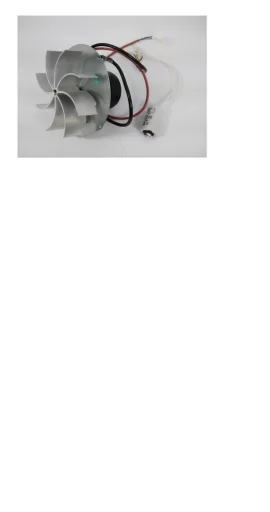

All the smoke ventilators I have seen for Ravelli stoves have the stamped (bent) sheet-metal impeller. I have never seen a curved one. Post a picture of it.
I can't find my old rotor - did I throw it away to remove the temptation ?
But this one is the same idea :
  • [Hearth.com] Ravelli Parameters

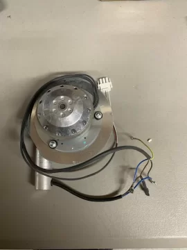

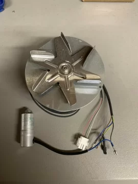

This is what the exhaust fan and motor look like in my Ravelli Elena:
