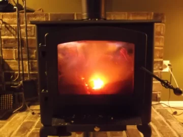

Nice packing on pic #2. Square splits are da bomb.

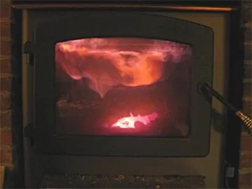

I never know when the secondaries will kick in. I have my expected norm temps but then sometimes I get surprised. You will learn your stove. Experiment. It takes time. Keep asking questions here because this place has a lot of experience and knowledge, and we love to share it and receive it.
That roll in the first shot was the first season with not dry enough red oak. The lignin in that stuff took off and that atomic bomb blast went on for a half hour.
Reactions: tfdchief
The second one was last month. playing with the new camera and showing that the guy that thinks secondary burn light shows are silly can kick it in. After the pic I gave it some primary air so it could go back to burning the way God intended trees to be burned.
