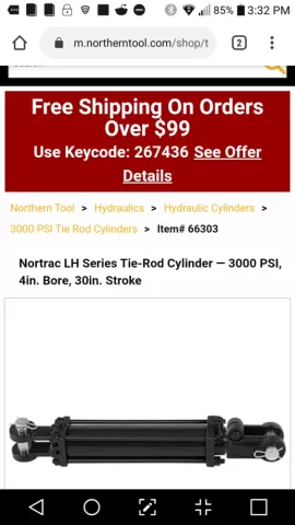

Northern tool For comparison, 4" x 30" x 3kpsi $260 with free shipping

prices have likely gone up a bit but a 24" stroke 2" ram 4" tie rod cylinder at 3000 psi used to be around $250 US ( this would be 1/2" ports)

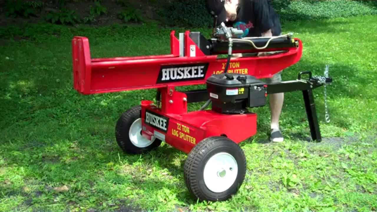

I have to admit I haven’t looked all that closely at them, since I bought mine a half dozen years ago, but isn’t the CountyLine just TSCs latest re-badging and paint job on the same Speeco-built splitters they used to sell in red paint under the Huskee brand name?
I'm not so sure that it is, those older machines used an I beam, no? The Countyline has a fabricated beam, as do many of the newer models (my Champion too)
I wasn’t sure, so I just looked it up. Beam and frame are identical, but they changed the engine configuration.

Yeah, I think it is. The old design used a vertical shaft engine, which really limits engine options, and a custom pump mount welded into the engine mounting plate. I didn’t really look at the pump mount on the new design, but I suspect it’s the more standard cast mount that puts the pump directly onto the engine, rather than using the splitter frame to carry each separately.

Was at the Amish shop today and the owner said his supplier told him that Blount (Oregon/Speeco) no longer supplies Tractor Supply with splitters as I had mentioned the County Line looking very similar to the Oregon/Speeco/Huskee. He said Oregon's "new" or at least newly branded Power-Pro splitters are the old Speeco/Huskee splitters since they had apparently lost their contract with TSC. I wonder (if this is all true) if perhaps TSC may be manufacturing copies of the Speecos with a Chinese manufacturer now . . . just thinking out loud.
