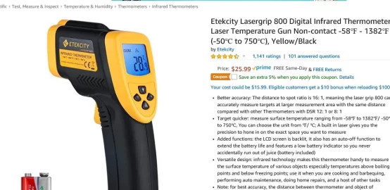

Like you I have a new BK Princess insert and have been burning for 2 weeks. I have a handheld IR thermometer like this.
[Hearth.com] Ready for first large burn and have questions
Lets me instantly check the top of the insert. If the shroud is not on you can check the liner and the appliance connector. I was timid at first, not letting the insert get above 450deg. I now let it get closer to 525deg, constantly checking the clearances and heat around the unit to make sure all is safe. I run it on low at night, get nervous when the firebox is full of flames (like I am going to ruin the combustor or damage the inside). I am told not to worry but like a kid, I am taking baby steps. I suggest the same.
