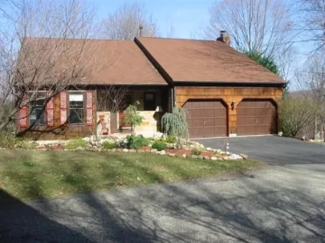

Here is a picture of a house that looks just like mine, I am in a community complex. Its a home.

Where were you intending to put the stove in this house? How open is the first floor plan? If there is a bedroom over the garage, it may be hard to heat. If so, you might consider having a safe, electric heater in this room.
