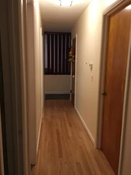

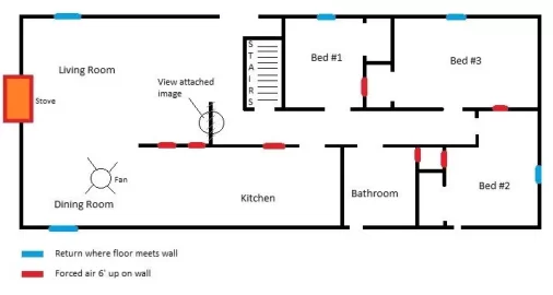

The wall will impede "assisted" airflow somewhat.
Normally the simplest way to move the heat in this setup is to blow cool air from the hallway, down low, toward the stove. There are two issues in this layout with that plan: the blocking wall and the narrow hallway. A fan looks like it would be in the way even if only 12" wide.
The second option is with a ducted circulation fan system. Which way to the stairs go, up or down? Is there a basement?
What's the difference between that, and simply the giant blower down in the basement that will take air from all of the intake ducts and circulate through the exhaust ducts?
In my image, that would be blue ducts to red ducts
