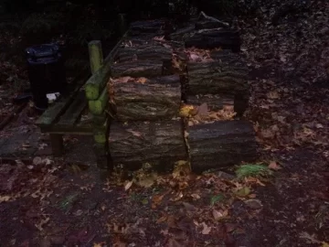

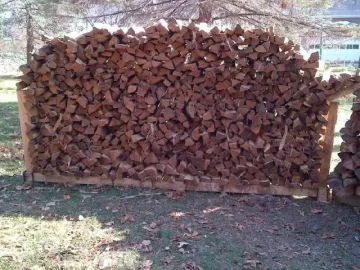

This is not what you want to hear but I tell you my experience. My first year I burned all locust that had been split and stacked for 18 mo and was not dry enough. It was frustrating, makes you want to blame the stove. Even dry locust is a tough wood to burn by itself. It is super dense which makes it hard to start and if it's at all wet, hard to keep going.
My advice is to split what you expect to use next year split ASAP and to split that pretty small. Also try to source some other wood. Locust is excellent but I prefer it mixed in with other wood. At the very least being able to add it after hot coal bed is established is helpful. So try to get some other dry wood, even wood from pallets will be a big help..
This is more like what my (limited) experience has been with it. When we first got the place 8-months ago I took out quite a few sapling trees (4-inch diameter max) that I cut to length and loosely stacked. I've been using them sparingly when I have a good hot bed of coals from the Red Elm and White Oak that I purchased for this year and they seem to burn pretty well and nice and hot when mixed with other wood. The trees I'm cutting now are 8 to14-inches in diameter and are (were) very much alive.
I did note that they have a low moisture content to begin with so I am hoping that in 11-months time they would be ready to burn. i will make every attempt to get them cut / split ASAP and stack them where they will get the most amount of sun this Summer..... guess 'm going to need that log splitter sooner than later..... as you can tell I'm pretty new to Country Living - but I'm determined to make it happen.....
I've just begun knocking them down and was planning on using them next Winter.....
Were they dead? I've found BL on the ground with no bark that was ready to go. If you've got a grove of live ones, you've probably got some dead around, too. They seem to succumb easily to wind or disease....
Don't really know what kind of summers you have in Nebraska so you may have better luck. As others said give yourself the best chance by stacking in single rows out in the open and again smaller splits than you might choose if you had more time. If you cover, top cover only. Some use old corrugated roofing which sounds ideal to me since it allows more air movement than what you would get w/ a tarp or other soft cover.
One other thing, locust bark will come off in sheets soon after it's bucked up. Take the time to get it off, it won't be difficult and holds a lot of moisture. Been doing that myself recently...

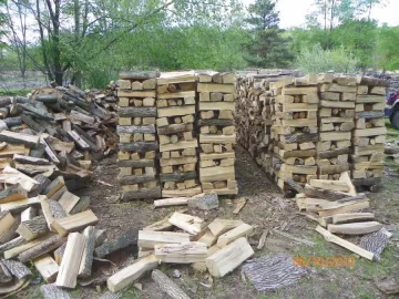

Welcome to the forum jkazak.
Congratulations on your new property and moving to the country. That sounds like a real winner and it sounds like you have some great firewood too.
Please do not get discouraged and do not misread the 3 year thing. We talk here about being on the 3 year plan and that is the ideal. It may take some time to get there but when you get 3 years ahead on your wood you will be amazed at the difference in how the stove puts out heat, the ease of starting new fires and the lack of any creosote in your chimney. In addition, you won't get taxed on this even though it is like money in the bank.
Locust we do not have but have been given a little to try (black locust) and the heat was great. We just did not like the smell. There is a difference between honey locust and black locust. Do you have lots of thorns? Nasty. But honey locust will take a bit longer to dry than black locust. Most that I've talked with say 2 years on the black and 3 on the honey but I also know of several who give black only a year to dry.
But the big thing to remember is that the wood really won't dry until it has been split and then stacked out in the wind to dry. You live in Nebraska so we know you get some good wind. That may indeed speed the drying for you but get is split and stacked asap. When you stack the wood, be sure it is off the ground. We just cut some saplings to lay down and stack on top of them. Here is how we do it. That first picture really shows the saplings that are under the wood. That last picture is some white and red oak that had been laying flat on the ground for over 10 years. It was on a neighboring property and we were lucky to get it. That was split and stacked last May and we'll probably try to burn some of that next year. Normally with oak, we want 3 years in the stack but this one won't need that much time.
