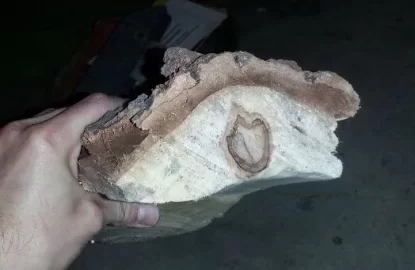

Hi everyone, I'm so glad I found this forum, its really an awesome resource.
I just purchased my first home in October and it has electric heat. It does have an open fireplace so I have been using that while I am home to help offset the cost of heating. Since I was caught off-guard, I have had to buy some wood for this winter, some well seasoned red oak. My plan is to install a wood stove over the summer that used to belong to my dad and keep busy all summer bucking and splitting wood. I can't wait because I actually enjoy it. I always used to do it just to have firewood for camping. I have a husqvarna 445 and 2 mauls and plan on buying an old pickup truck (my Jeep Cherokee can't hold that much wood haha)
My brother-in-law does own some land with tons of downed trees that have been down for a few years. It was being selectively logged but the loggers ran out of money and the workers walked off the job. A ton of downed trees have been left behind and I have been told I am more than welcome to all of them so that is a huge score.
I'm really into ID'ing the species and learning about each of them. Leaves are out of the question since they have been down for a few years so I am mostly going by bark. So far I cut up 3 trees. One I believe to be a sweet cherry, one I know is a sassafras (might keep that for camping wood or until I get the stove, it pops like crazy in my open hearth! I can put the screen up but I don't get as much heat when its in place. I like to move it while I am on the couch right there watching it.
Anywayyyyyy, I am having one heck of a time identifying the 3rd tree. Every time I think I know what it is I see another picture that makes me doubt it. It was very hard to split, sometimes the maul would bounce right off it and its super heavy. Its not a conifer. I was thinking white poplar maybe? But then when I look at pictures it just doesn't seem right. Nothing I've seen so far has been a match in my eyes. Can anyone identify this? Underneath the bark it is a sort of nutmeg orange brown and the wood is very white with silver streaks going through it.

Im guessing Big toothed Aspen.
The gray streaks are the beginning stages of decomposition.

To me it looks like a partially punky oak of some kind.

Aspen for sure.

cottonwood, poplar or willow , I'd go with willow . What does it smell like? like crap? most likely willow.

You have some popple (aspen) there but what I'd like to home in on is the above that is highlighted in red.
