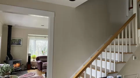

Hi everyone. I am in a tri level house. Each floor is 800 SF. The stove is in the middle level which has 16' ceilings.
The stove is located approximately 18' from the bedrooms and in direct sight of the half stair case up.
I'm having an issue moving heat up the half flight to the bedrooms. Currently, I'm cranking the heat out and have the stove floor at 86 degrees. The bedrooms are at 58 degrees. I feel like this is a pretty drastic difference when the bedrooms are only 18' away from the stove and up a half flight.
The windows and walls are pretty well insulated up there too. I've tried all different fan combinations of blowing the cold air towards the hot air without luck.
I really can't stand to try to make it hotter in here on the middle floor.
Any ideas or am I asking too much of the stove?
