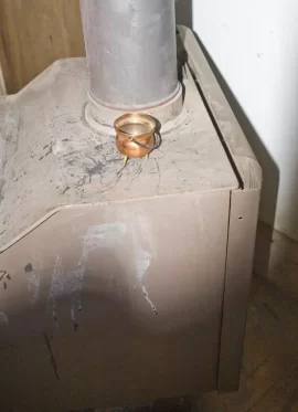

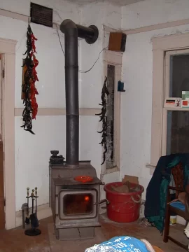

This might be really dumb, but this no-name stove has been perfect for us for more than 20 years. It's very easy to start a fire, it burns for a long time, the door is as tight as ever, the outside stays relatively cool, and all you need do to get the recirculating part going is push in the rod that works the baffles.
But. The bars that make the baffle system have burned away so all the heat goes up the chimney. Our neighbor has a big metal shop -- builds and rebuilds all kinds of farm equipment -- and is a genius welder. As far as I can see the only way to get into the baffle area would be to unweld the top sheet. Has anyone here tried to rebuild a stove of this type? Any opinions as to whether this would be worth even thinking about will be gratefully received. I feel a little leery about the complex new stoves, even the relatively simple ones like the Napoleon S25. (It's been a fight to find any stove within our delivery area! The Napoleon is one of the few that's actually available.)
