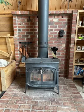

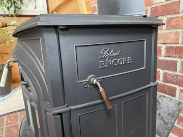

Hello all,
The time has come to make a decision on whether to rebuild our Vermont Castings Defiant Encore wood stove or pull the trigger on a new wood stove.
The defiant came with the house we bought a few years ago, and clearly showed signs of being over fired, The new parts needed, upper and lower fireback, A new damper assembly and refractory, Gaskets etc will most likely set us back about 1200-1400ish, And I'd be doing the rebuild. That said we love the stove and wonder how it would perform if it was operating properly.
Wanting to make the right call but There are so many choices its easy to hesitate, The new stoves obliviously conform to EPA standards and would offer more than our older Defiant. Some of the stoves I've been looking at are the Woodstock Ideal steel hybrid and the Ashford 30, And Lopi. I've read some great reviews on them :). The Stove would be in our living room with a cathedral ceiling and heating app 2-2,200 sq ft.
I keep coming back to the Woodstock Ideal for some reason although it weighs in at 620lbs and I wonder about my floor joists., not sure how much the Defiant weighs . What are your thoughts? Are there some other models that stand out among the crowd?

Other with direct experience can offer specific insight but if I had to choose between the VC or an Ashford I’d choose the BK. What shape is the chimney in?

Thanks for the repys, EbS-P its 8 inch pipe and in good shape, Joop I'm 50/50 with this going either way, that's why I thought i would throw this out there and see what everyone's thoughts are... My wife and I love the VC large glass doors for the fire and it's a great looking stove but it sure does need attention. Wondering what burn times I could get after a rebuild?

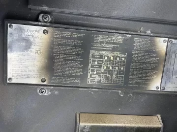

begreen, Defiant Encore 0028 or 2140, Model # Not listed on the back tag I far I as can tell, but the catalytic panel removes from the back of the stove and it has the top load lid.

Ok the cat models are definitely much better but personally I still wouldn't spend the money on it
BKVP
The label mentions 1988, which is Phase 1 of the first federal regulations on woodstoves.
1990 was Phase 2 of that rule. If it was made after 1990, the label would bear that date.
So VC owners could clue you in to which model of Defiant, catalytic, was made in 1988.
