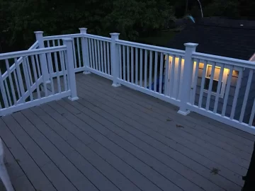

Mahogony sounds expensive and the stain and finish coating adds a lot more to the cost not only in cost of the stain, brushes and your time too! Plus yearly re-treatments.
Our old cedar deck rotted and the brick and Morter stairs crumbled!
We rebuilt our deck and stairs last summer and now we are free! ! !
I got fiberon railings and the very best Azec Decking and a couple 12 vac low voltage post caps with the Merlin control. No more costly maintenance and ugly deterioration, like the Maytag repair man! Sit and relax as it always looks brand new! just my 2 cents
See pics. Click on pic to Enlarge:
How does it look now?
