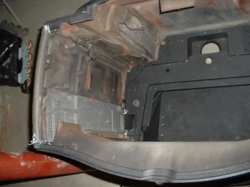

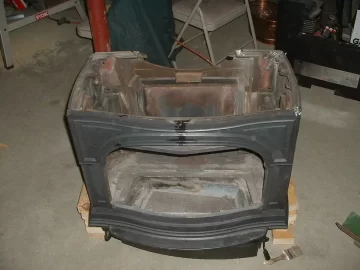

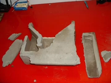

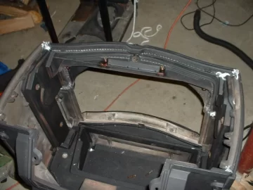

Here's some pictures>
  • [Hearth.com] Rebuilding a VC Defiant. Now with new pictures!
Nice pictures, thanks! What is your "game plan" on the stove? Are you taking it further apart or are you at the back together part? I ask because when I was "stove shopping" I came across the same stove that needed rebuilding. I passed on it as I didn't think I Could make it fit with the way the flue came out the back.
I am just starting to put it back together. I have cleaned up the bottom pieces, replaced the mild steel fasteners with stainless steel, painted all parts, & regasketed them.

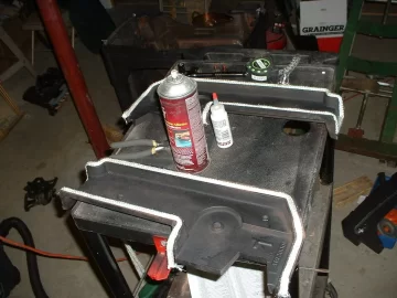

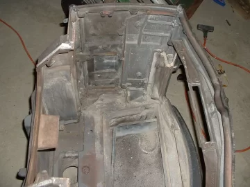

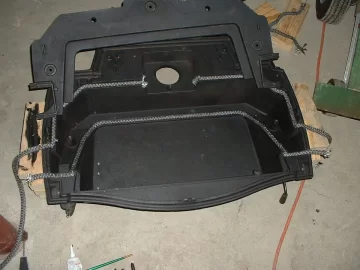

Pictures>
tiber said:
Through neferious technical means I can get the PDF manuals out of the Vermont Castings site. I think they make it hard just so people will have to run the stoves into service. I have posted the encore manual and encore manual addendum to google documents for you:
Vermont Castings Encore manual
Vermont Castings Encore manual addendum
That's great but this is a Defiant NC stove. LOL! I do need to see how the rope gasekts are supposed to run.

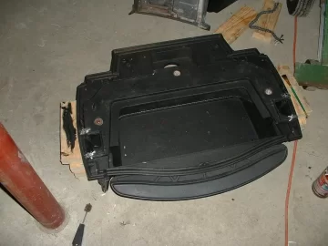

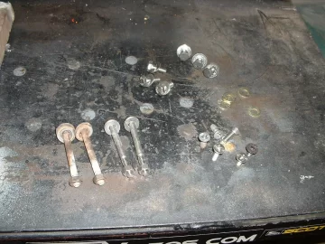

Here are some current photos. Waiting on parts from Jay from Ace Hardware.
Hey Bill,
Looks like your rebuild is coming along. How did you make out with the refractory reconstruction? I heard from a guy who said he uses some sort of new high temp silicone in place of the cemment on the seams. But it looks like you are doing fine with the current rebuild. Looks like you are doing a great job! Good luck.
Chris
Jay that works at Ace Hardware (on this forum) is selling me a "slightly damaged" ,new heat exhanger refractory box for $20. It just has one of the sides of the 1/2 refractory board cracked. So I'm going to use some furnace cement or high temp stove gasket glue and some stainless steel pins to fix the cracked piece. Honestly,..I bet you could just set the pieces in there cracked & it would be fine.
VCBurner said:
Here's an article on building refractory parts in case you're interested. This was written by another Hearth member.
http://gordosoft.com/woodstove/refractoryDIY.htm
Yeah I saw that,...pretty good BTW. THis is not a cast piece though, it is actually a piece of 1/2" refractory "board" that is glued & screwed to the cast piece which is still in ok condition.
