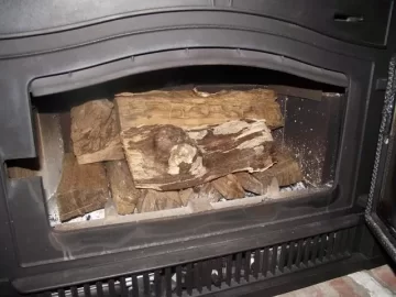

I'm back baby! I took this pic of a medium load and I notice that on the lower hinge side of the door there is some blackening outside the gasket. Too much? Do I need to tighten?

Maybe. Keep an eye on that area and do the dollar bill test on the gasket. Is it my imagination or is the firebrick darker on that side too?
It is not your imagination but its not always the case. I think a N/S split way laying on the brick the last burn. Just about to search dollar bill test to see how tight is good enough when I saw your post. Freaky _g.
