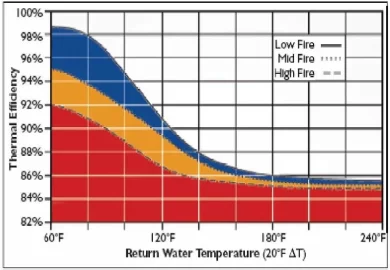

Ok, as long as your infloor supply temps can be kept at the sweet spot (96-115) for the boiler then you can see the 90 plus efficiencies. Good design and a very good installer will make it work like it supposed to.
Well the HP makes 8-9 gallons of tempered water per hour in hot climates, standard electric makes 21 gal/hour, and a gas 100 plus/hr. Very low usage and demand in a hot climate is where a HPWH works as described. It really depends on what fits your needs. But if you have a mod con going in, why not buy just one water heater for the rest of your life. A stainless superstore or similar. If your flow is under 4.5-5gpm a small 20-30 gall will give you endless hot water with .3-.5 degree standby loss.
Well I'm trying to post a chart lets see if it works. Return Temp, fire rate, vs. Efficiency thermal overall mod con [Hearth.com] recommendation for a mod/con gas backup boiler?
