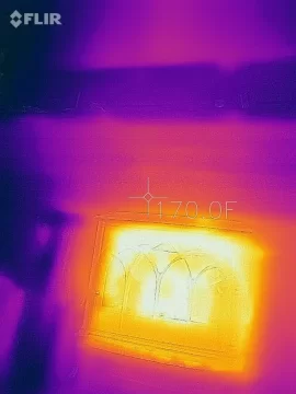

I don’t have an insert but rather a hearth mounted stove but my brick above the stove and below the mantle can get well above 200 degrees. Steel lintel can get well over 300 degrees. Top of mantle can get to 140.
In the picture the stove is rather cool, probably just coals, as the FLIR camera maxes out around 300 degrees.
how much do you plan on burning?
That's huge help, thanks for posting that! It's nice to see some real numbers.

The temps reported are for a freestanding stove in a fireplace. They will be notably hotter than those seen with an insert due to the convective jacket surrounding the insert.

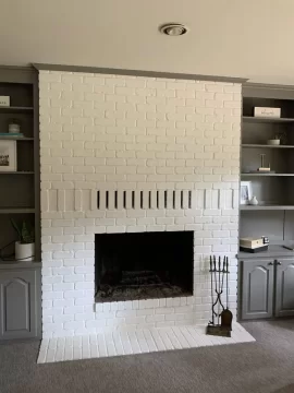

Here’s how it turned out for anyone wondering or comes across this thread in the future. I used multi purpose latex primer and Extra White acrylic paint from Sherwin Williams. I Wanted to use their Loxon primer but it was completely sold out in my area. We’ll see how it holds up this winter.
