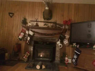

Here it my living room situation. The stove does better than I though it would. I get 6 hours of good solid heat out of it then itll start to die off. I can easily get the fire going again after 10 hours as theres coals still left at that point.
